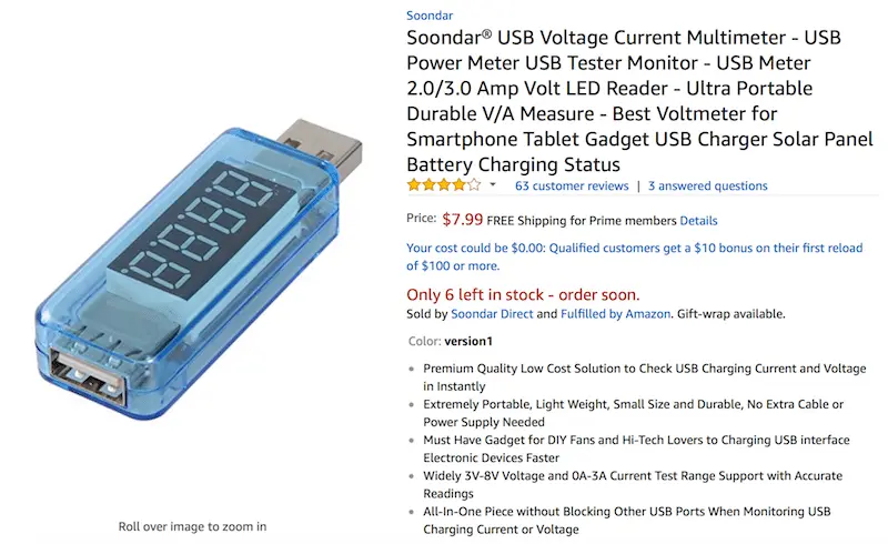

Whenever I have problems with charging a usb device I use one of these which allows you to check the input voltage, the supply current and the time taken. Very useful device and cheap as well! P.S. check original post first page for LINK.

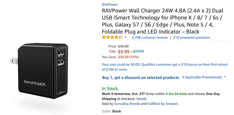

Amazon has a number of inexpensive devices that can measure the voltage and amperage between the charger and the iDevice - I own the one below and just tested 5 chargers that I own w/ my iPad Air 2 & wife's iPad Mini 4 - one included the original Apple charger that came w/ my iPad, i.e. a 10W (5 Volts x 2 Amps) - all chargers put out 5 V but only 1 Amp - the exception was my newest purchase (second pic) which claims to produce a total of 4.8 Amps w/ 2 devices attached, however, I measured only 1.3 Amps - SO, why doesn't the Apple charger (and the one below) measure 2A & 2.4A, respectively? Are the chargers the issue and/or my USB measuring device? Do the iDevices draw less charge when approaching 100% - likely? Should I buy another volt-amp unit?
Note that Apple recommends 10W or 12W chargers for its larger iPads (and even more wattage chargers can be used, especially for the iPad Pro) - just not sure why I'm not seeing 2A from my Apple charger and 2.4A from my newest charger below? May just buy another testing device - they are cheap on Amazon. Dave :)
ADDENDUM: A lot of these dual output chargers will state 5V x 2.4A implying that each output port puts out that amount, but in reality the 2.4 (or 2 in older units) is split in half - rather misleading if not read carefully - believe several of my older dual chargers qualify. :mad:

Giradman: perhaps try a load resistor and see what current is drawn from the chargers. Probably only a few seconds would be enough to get a reasonable current reading, but note the resistors could get hot, depending on value, size and resistance.
