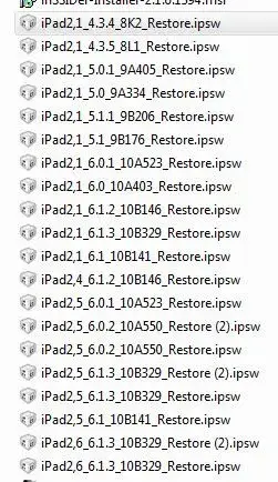

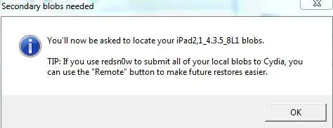

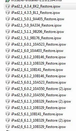

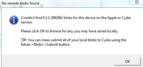

here is what I tried. in redsn0w, I went to extras, even more, restore, IPSW, I selected this file iPad2,1_5.1.1_9B206_Restore.ipsw redsn0w.jpg, then I selected iPad2,1_4.3.5_8L1_Restore.ipsw, device goes into recovery mode, then I get this redsn0w pic 2.jpg, then I click on local and I get this redsn0w pic 3.jpg so I select, 00000B0F38FA938A_4.1-8B117_cydia.shsh and it doesn't like my blobs. I tried remote also but I get this redsn0w pic 4.jpg

That's actually not possible. Build 8B117 is 4.1, and the iPad 2 Wifi model began on 4.3, and the Rev-A model back on 5.1, so iOS 4.1 never existed on the iPad 2. You're using blobs for another make and model of device. Blobs and/or APTickets must match that of your specific device

Did you ever save the blobs for your device (usually with Tiny Umbrella)? As willerz2 said, you can only used blobs specific to your device - and you must and can only save them at the time Apple was signing that firmware. In other words, you can't save them after the fact.

You have 5.1.1 blobs with valid APTickets. Your 6.1.2 blobs are fragmented and do not include APTickets, not that it matters at the moment since you cannot selectively restore to 6.1.2. Since you do not have iOS 4 blobs for your device, you cannot downgrade to 5.1.1
