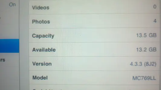

I just uploaded a picture from the about screen on my iPad1 showing that it is 4.3.3 8J2...I followed redsn0w and snowbreeze instructions exactly.

OK Needz, but then I need to call you on the other glaring problem.
Model Number MC769LL
This is an iPad2 Model number. It has NEVER been an iPad1, and you CANNOT Jailbreak an iPad2.
If you want to check, you can buy it at Amazon - [ame]http://www.amazon.com/Apple-MC769LL-Tablet-Black-NEWEST/dp/B0013FRNKG[/ame]
I would have never guessed! Dude, if you were trying to fool us, you did! :D

I actually have an Ipad one, purchased from the Apple Store two weeks ago, which has the exact same model number. Unless Apple is selling Ipad2 in an Ipad1 box and body, I am pretty sure I didn't get an Ipad 2.
I am also experiencing the same problem with JB.
