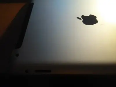

Is that the item in the bottom left of my photo, next to the small slide switch? If so when I press that item, it clicks as if it's a press switch? I can't see a tiny hole there? Either I have the wrong item, or I've got it completely wrong.

Ah, I've found it! Thanks again.
Do you have to press hard with a thumb tack in that small hole? I tried with the blunt end of a needle first, but perhaps I need quite a bit of pressure? Then I'm guessing that tray just pops out?

I tried pressing the end of a paper-clip into that hole, but couldn’t get it to make the tray come out. Don’t know what I’m doing wrong.

Use a thumb tack as it requires quite a bit of pressure to pop out the SIM tray, Your reseller is giving you the runaround. Either they know something that they aren't telling you or they don't have a clue about how to diagnose the problem. The best way to diagnose is to try a known working data SIM card into the ipad. Try taking it to a another place like a service provider and they should be able to try a different card. Or if you know someone else with a GSM capable ipad , try swapping SIM cards to see what happens.

Also there are many ways to reset the network settings. First go to apples website or simply search online for keywords apple SIM card iPad 2, that will get you to instructions on how to open the sim. You need something small and long to open the tray and sometimes it can be tough to open. Next search for resetting my network on iPad. There are setting in the menus under reset. Just remember your pass codes .
