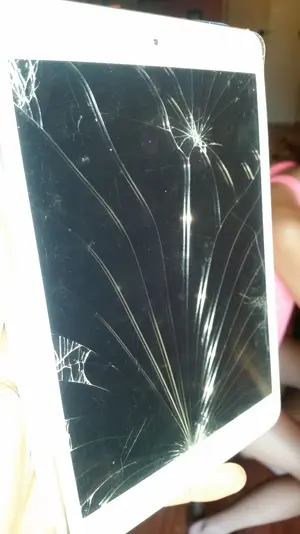

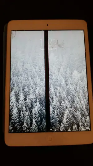

I have a Gen 1 Ipad mini that has a broken screen and possibly a screwed LCD panel. As you can see in the second picture I have this line running vertically through the entire screen. What is the best way to remedy this for a decent price? If this happened to you did you fix it yourself, (if so what tools?), and does this vertical line mean I also need to replace my entire LCD? Thanks guys!

It certainly looks like you'll have to replace the entire panel, glass and screen. When a screen develops a fault like yours, there's no way to repair it, it must be replaced.
Unless you're familiar with iPad screen replacements, it would be better to have a qualified repair shop do the work. A third party authorized repair shop would be cheaper than the price Apple charges.
Well, you need to decide if a repair is worth the cost vs. what you likely will obtain on a sale - take a look at the iFixit Website HERE and determine 'how much' a DIY fix would cost based on the number of components needed (as mentioned already, the device likely requires several repairs). Then look at the attached chart (Source) for one estimate of what the original iPad Minis are worth - not trying to dissuade you, but may not be worth the effort? Others who have gone through this process hopefully will 'chime in' - good luck. Dave :)
If you go to a repair shop you are looking at about $150 -$200 to replace both the lcd and digitizer glass. If you DIY parts will run around $120-$150 . If you are new to ipad repairs or electronics repair in general the process will be challenging.
I would recommend replacing the ipad with new or used and selling the old one for parts. Be sure to reset all settings and remove icloud lock before doing so.
If you do decide to DIY , watch the videos on youtube (I recommend iCracked and IPad Rehab). Remember to disconnect the battery from the logic board BEFORE disconnecting the LCD and digitizer, otherwise it will get alot more expensive to fix.
I repair glass, digitizer, and L.C.D. components all the time. What started as a repair on my iPad 2 has developed into many friends and their friends and so forth etc. From the photo you displayed your lcd
screen is trashed . . Unfortunately, the I pad mini and the i pad air , repairs are more expensive than the bigger I pad 2 or I pad 1generation .
Hears the deal , you can purchase glass , digitizer and the home button
as a package deal. And the lcd screen is separate. They are relatively inexpensive if you get a non original equipment parts. However the labor for these (mini, air, ) is really high. And if you take to apple to repair they will only install apple parts. Now your price really just went up.
Both SciFan , and Giardman are exactly right. By the time you paid to have this repair you could practically buy another I device . My suggestion to you would be this . Look on Amazon , they so often (many many times ) have what is called not new I pads for sale . What that means is usually it's the packaging that is damaged.! There absolutely nothing wrong with the device. I know because I have purchased 2 iPads
