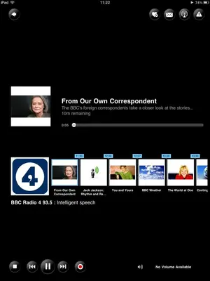

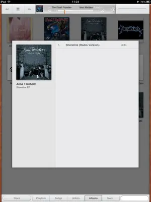

I've just restored it again on iTunes but I still get no sound.
If you look carefully at the photos you can see there's volume slider?

Well, this is certainly a new one on me!! I've never seen "Volume not available" before.
I am going to go away and think about this one - fascinating (for me, not for you!)

It's working again now. I toggled the 'sound check' checkbox (music settings) 'on' and 'off' a couple of times and it fixed it!
I don't know what 'sound check' does but toggling it did the trick :)
