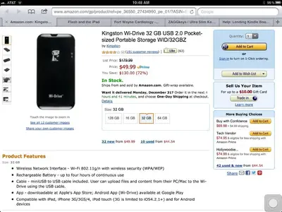

I just got an email from Amazon telling me that the Kingston 32Gig WiFi Drive is on sale for US$49.99. This is cheap enough even for me! I do not know if this price is similar discount in other countries besides the USofA.

The WiDrive could serve some of Steve's needs as well. Since it comes with fixed storage, there is never a need to format it, so no need for another PC.
The downsides I see are 4 hour battery life the claim. Also, the fixed storage. Even the 128 GB version is limited compared to a the Goflex (but the Goflex is spinning media, not solid state). Compared to the Air Stash+, one needs a cable to use the WiDrive with any PC/Mac...the Air Stash+ has a usb port built in. The Air Stash+ is infinitely expandable.
