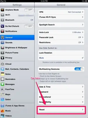

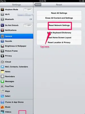

Lajafowokan said:
How does one "Reset Network Settings" on the IPad 2?
Just like Kevin said in his post. Here are some screenshots to help.
<img src="http://www.ipadforums.net/attachment.php?attachmentid=31634"/>
<img src="http://www.ipadforums.net/attachment.php?attachmentid=31635"/>
