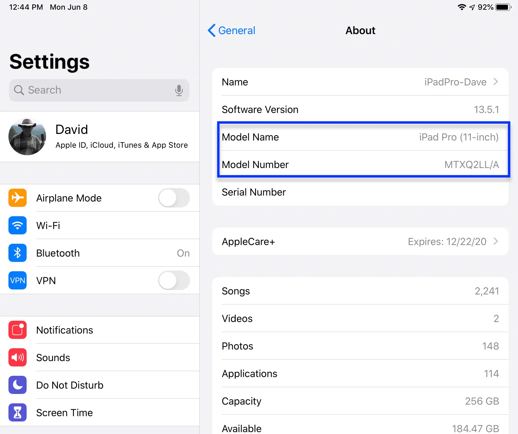

Hello Pinkipad2 - first, congrats on your 'new' iPad! :) Second, just so we know exactly which iPad you bought, please provide the information below boxed in blue, i.e. model name and number (information is found in Settings > General > About). Your iPad should have come w/ a charger and cable.
Now, you need to clearly explain your statement bolded above - are you saying that if your 'new' iPad is plugged into AC w/ the 'new' charger/cable that your battery is still being used up and is exhausted by 4 hrs? Thanks - Dave

iPad 7th generation
MW752LL/A
