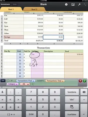

Hello everyone I'm having an issue with my formula on numbers. I'm trying to create a banking log to track my spending. I want to have a check list control weather or not the total given is added to the category or not. But im unable to link the IF and SUMIF statements. Any help would be greatly appreciated.

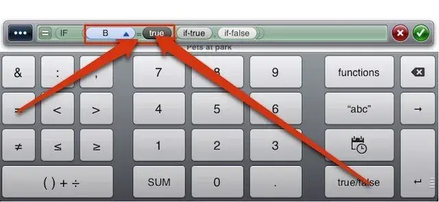

One is to be more explicit with the condition test in the IF statement. I had problems with checkmarks evaluating as TRUE before, even though the bare-bones method you used should work.

Thank you for your reply I've tried both ways using the IF("Transactions::B=True", as well as selecting the ranges but it still doesnt read the value. Here is the link to my spreadsheet hopefully you have better luck than I do.

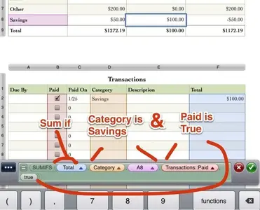

The mistake is using the IF function at all. IF can't test an entire column of values. I realized this when I decided to simplify the formula and test each part individually. No matter what I did I could not make IF test as true with more than one cell selected. (Though in hind site I wonder what would happen if I made all cells in the selection true. That could be a handy trick)
Fortunately, you don't need to. The IFSUMS function can test for multiple conditions. By testing for both (Category = A8:Savings) and (Paid = True) you get the results you want. The picture should make it clearer.
I did not test it beyond the one entry, so no guarantees, but I think it will do exactly what you want.
