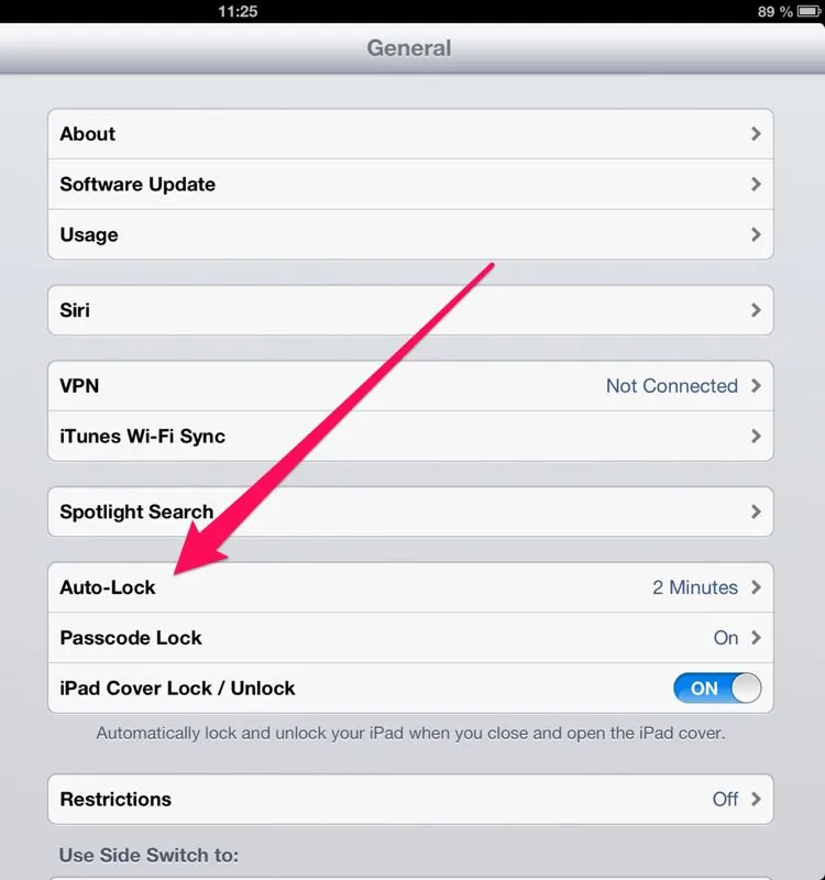

Hi there! Welcome to iPF!
Did you set a time in Settings - General - Auto-Lock?
If you did so, please inform if it's working or not.
Also, there's the question if you use a Smart Cover, and if so, how it works.
The only advice I could give you so far would be to reset your iPad. Go to Settings - General - Reset - Reset all Settings.

It's possible your Smart Cover is not compatible with your iPad. Apple did change the polarity alignment of the magnets in the cover, which could affect its operation with certain iPads. Have you tried it with another Smart Cover? The settings option to lock/unlock with iPad cover doesn't appear in the settings menu until the first time a Smart Cover is successfully used.

The magnet sensor could have gone bad or got stuck. Try thumping the area where the cover closes (gently). I can't think of anything else. And since you've installed iOS 7, I can't even suggest where to look software wise. Could even be a bug in iOS 7, for all I know.

Try taking your cover, don't connect it, but slowly move it up the face of your iPad on the right hand side and see if the magnet does activate at some point.
Alternatively you could try with a very small magnet to find this point.....once found, the lock/unlock setting should appear. Hope this helps.
