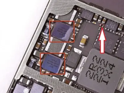

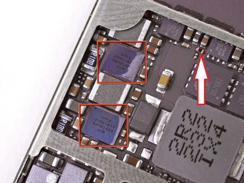

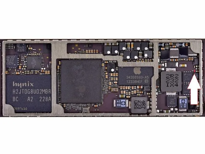

got a wee problem, I have a missing component on a logic board model A1432, has gone accidantly when I was replacing screen backlight fuse :(
now no screen at all, no picture no backlight :thumbsdown:
I still looking for someone with second model just for a mesurement example but no luck yet
maybe one of you guys can be faster...
can anyone help me to identify the missing component - I think its a resistor or capicitor but what value??

Hi
This thread is old but for information
Component is R2205. This is a resistor
100k
1%.
1/20 W
MF
201
