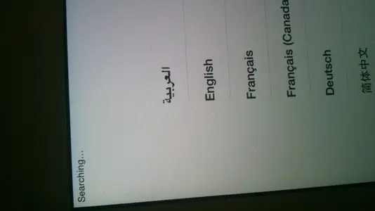

Hi All,
Did a hard reset on my iPad, now while trying to activate it, it says ''“Your iPad could not be activated because the activation server is temporarily unavailable.” Also iTunes displays the same message while trying to activate it through iTunes.
Did a hard reset as the signal kept showing Searching... and the iPad kept restarting. Now i'm stuck in Activation Loop from past 1 month. iPad is bricked. Tried DFU mode and updated to latest ios8.1, tried manually pushing an ipsw through Shift+Restore for ios6, but still it reaches the activation screen which i cant get past through. Apple doesn't touch iPads with a hardware issue, and only solution is to replace for half the price of a new iPad(mine is out of warranty). Any solutions? I just need to activate it manually. The BLOCK:mad: is only the activation.
I don't understand:eek: after taking immaculate care of this iPad(Never fallen down/ no spillage of any liquids:rolleyes:), how come it still conks and the only solution Apple can give me is replace it for half the price of a new iPad!!!
Also i noticed, on the Welcome screen of activation, the little blue info button to the right bottom....DOES NOTHING:(
