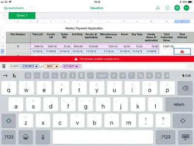

Hi there. Can any one help me with a formular. I have a row of numbers. I want to be able to add the date I do an item under it and this date will trigger the numbers to Sum at the end of a row. Here is what I have so far, please don’t laugh I’m a scaffolder. Lol
The conditional part of the formula is a text field. You don’t (can’t) use a cell/selection to fill it. Tap the Text entry button and create the conditional that way. Example below.
