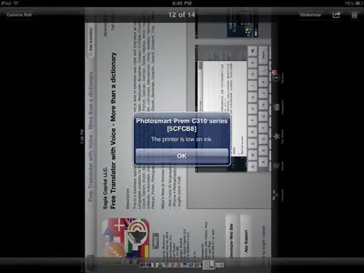

I happened to have a 4x6 Index card handy and I put it into the top 4x6 tray and tried again. It printed. However, the iPad still displayed an error? See the attachment.
Irv S.
