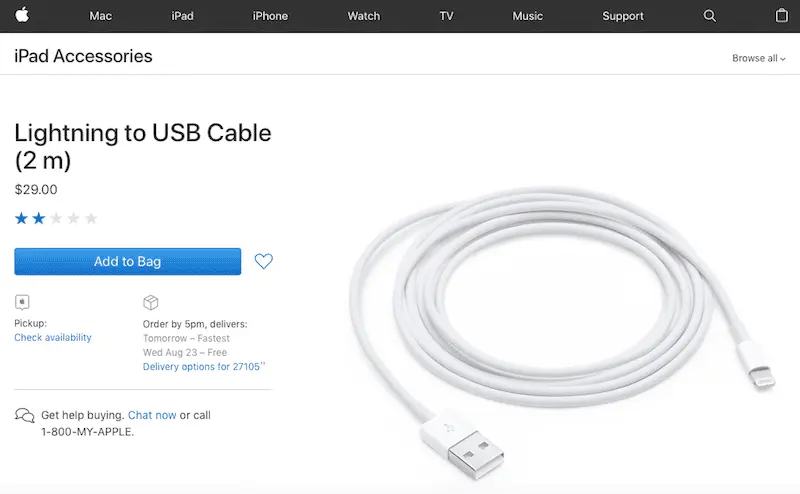

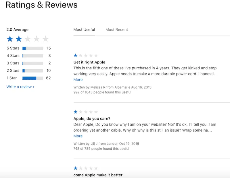

Hi Hunter - there are only opinions based on experience that can vary widely - I've bought many iPad/iPhone cables over the years and failures are common regardless of length and brand - tossed out many, especially those my wife have bent at the lightning connector. The ones sold on the Apple Website (or their stores) are expensive ($29 for a 6-footer) and the reviews there are rather poor - one would think that Apple would 'get it right', but apparently not - :confused:
Now, I buy most of my cables from Amazon and largely base my purchases on the reviews there, which can still vary widely; the 'Amazon brand' cables seem to receive better ratings (as shown below, last image), so you might want to look at those offerings. Otherwise, read the comments carefully - obviously the pricing is MUCH better than quoted at Apple (e.g. 3-4 'other' cables vs. 1 Apple cable) - but expect to be disappointed occasionally, unless you're one of the lucky buyers - my 2 cents worth. Good luck - Dave :)
