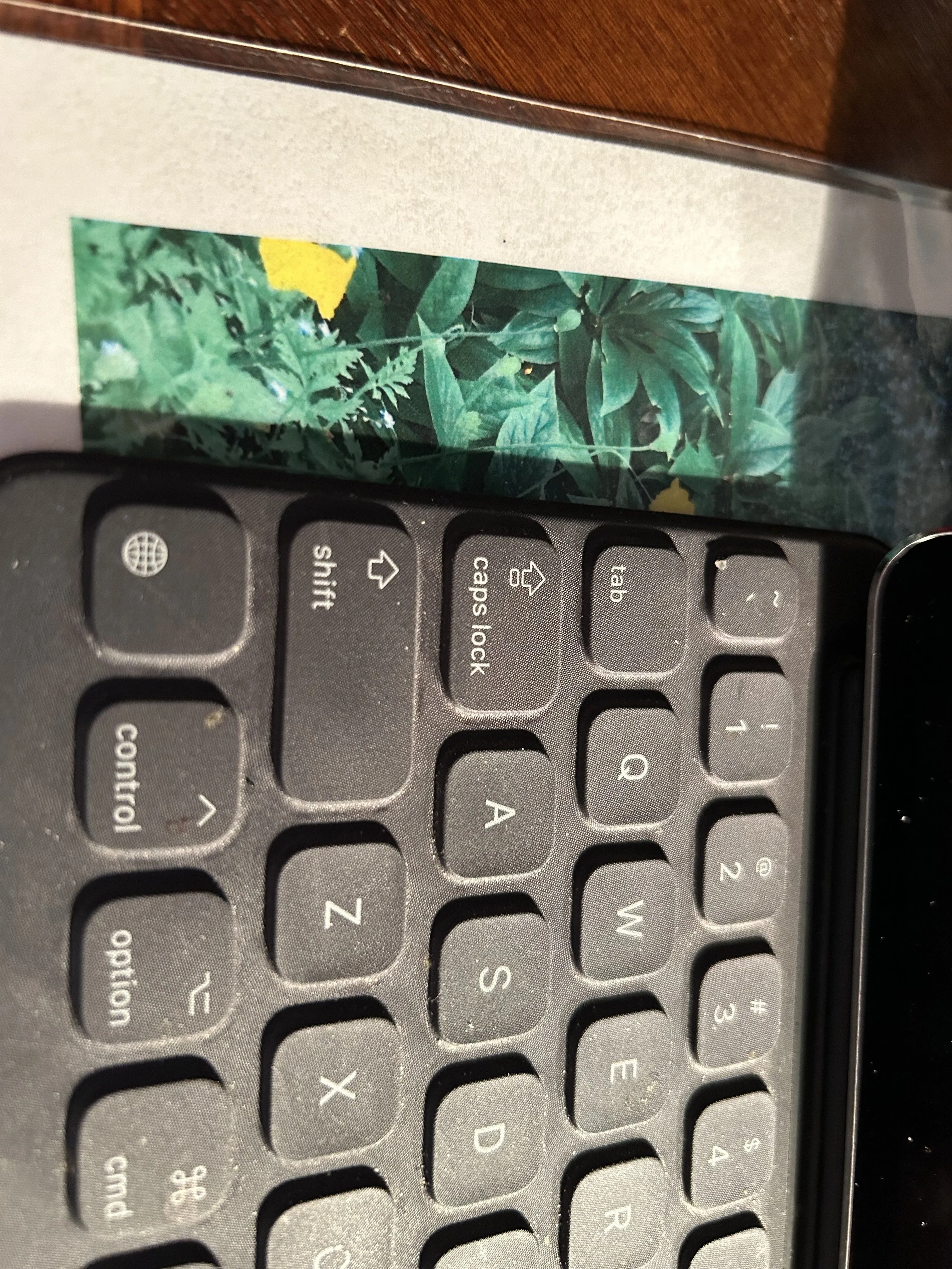

For some months now, I have found the caps lock on when starting my iPad Pro (iOS 17.3.1) with the Apple hardware (detachable) keyboard. It wasn't always this way, and it doesn't always do it. I am unable to associate it with any particular app or situation. it will do it in an e-mail, SpanishDictionary, or SMS Messaging. It goes off when I tap the Caps Lock button, but by then, I've often typed half a line. It is annoying to have to go back and retype what I have just input. I've tried turning off the iPad and restarting it; looking off a setting in Settings (turning off Enable Caps Lock in General has no effect), and under Hardware Keyboard, but no luck. Any ideas? Thanks.

Have you checked for any debris around the Caps lock key causing it to stick?
The keyboard has a sealed rubber cover so there's no way for debris to cause it to stick. I carefully checked the button, though, and it does not stick at all. So, sorry, that's not it.

It's probably a hardware issue with the keyboard. At a guess, I'd say that the process of opening/closing the iPad keyboard case is causing the Caps Lock key to be pressed, either through an internal short, or otherwise.
A quick question, when you open the case, do grab it anywhere near the Caps Lock key? A long shot, but really the only thing I can think of that doesn't mean the keyboard itself likely has a fault.
I'd also suggest a close look at the key for any deformity or other indication that it might be physically off, but your picture of it looks good, so probably not.

Thanks for your considered response.
It occurred to me too, that I might be pressing the Caps Lock key when opening the keyboard, so I carefully avoided it a few times, but the problem recurred.
No, the key does not appear deformed or in any way damaged.

I've had a few days to see the results. The workaround I used (turn off the Caps Lock button under Settings) has consistently worked. I did borrow my partner's iPad keyboard and did NOT experience the issue, so I'm fairly certain the problem is with the hardware and not the software, and the real solution is to replace the keyboard. Not sure I'm going to do that any time soon. Thanks for your help!
