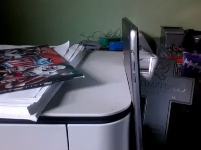

Here's some pictures that might help you see what's going on. (I had to use my computer's webcam to take these pics)
If you can't tell from my blurry webcam, there's a visible gap from where the volume down button is, all the way up to the upper right hand corner.
Here's some pictures that might help you see what's going on. (I had to use my computer's webcam to take these pics).... If you can't tell from my blurry webcam, there's a visible gap from where the volume down button is, all the way up to the upper right hand corner.

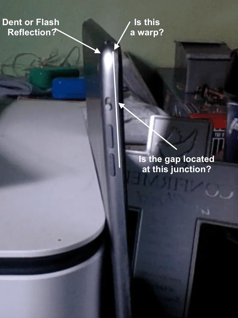

Thanks for the pics - I've done a screen capture below and added a few questions - please address - seems to me a 'warp' (presumably drop on that corner?) which likely has opened the gap adjacent to your volume buttons - don't see any 'dents' where the buttons are located but there may be internal damage to the volume mechanism - you probably need a professional evaluation at an Apple store or authorized Apple repair shop - hopefully, others will 'chime in' w/ opinions - good luck! Dave :)
1. That is a flash from my webcam. 2. Since you described what a warp is, I would say that is more of a warped side than a dent. And 3. Yes, that is where the gap is located at.
That's a pretty substantial bend ! I would recommend taking it to a reputable repair shop to get that along with the volume button issue fixed. If you are going to diy, I strongly recommend removing the glass, LCD and motherboard before doing so. Trying to bend it back as is may damage one or all of the above.
Thanks Brian for responding - looks like a 'professional' evaluation is needed and not an amateur attempt - Dave :)
That is different and more extensive than what I was thinking. A agree with Brian, that a pro shoul do it, unless you are experienced and comfortable enough to do it yourself. Holding in mind there is a substantial risk of damaging the iPad further.
What I was thinking was a slight warping of the aluminum between the bolume buttons; something I've seen personaly, and a couple times on the forum. Careful work with some small hand tools can fix that with little risk, and without opening the iPad.
