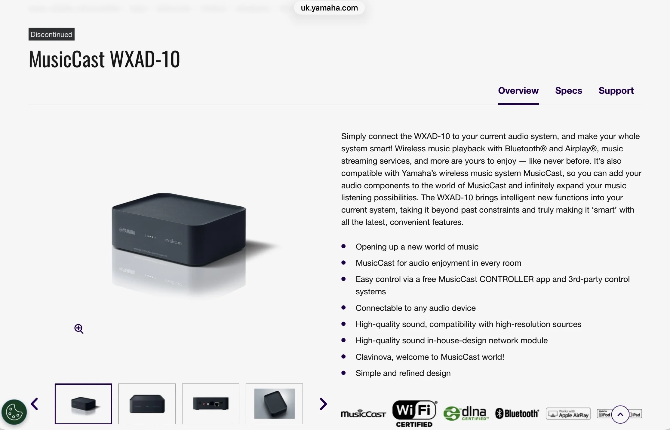

As a point of interest I sometimes play music from my iPad through my old HiFi. I use a Yamaha DAC (Digital Analogue Converter). The unit wasn’t expensive, is small and works very well. Also completely wireless at the iPad end.
Edit: Now discontinued. Maybe someone else makes one though? Picture for reference.
I've done quite a bit of looking and cannot locate a similar item being offered anywhere. Thanks for the effort to help though.

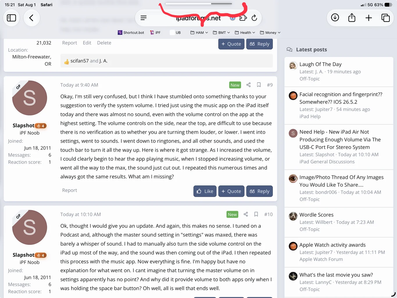

Okay, I'm still very confused, but I think I have stumbled onto something thanks to your suggestion to verify the system volume. I tried just using the music app on the iPad itself today and there was almost no sound, even with the volume control on the app at the highest setting. The volume controls on the side, near the top, are difficult to use because there is no verification as to whether you are turning them louder, or lower. I went into settings, went to sounds. I went down to ringtones, and all other sounds, and used the touch bar to turn it all the way up. Here is where it got strange. As I increased the volume, I could clearly begin to hear the app playing music, when I stopped increasing volume, or went all the way to the max, the sound just cut out. I repeated this numerous times and always got the same results. What am I missing?
Ok, thought I would give you an update. And again, this makes no sense. I tuned on a Podcast and, although the master sound setting in "settings" was maxed, there was barely a whisper of sound. I had to manually also turn the side volume control on the iPad up most of the way, and the sound was then coming out of the iPad. I then repeated this process with the music app. Now everything is fine. I'm happy but have no explanation for what went on. I cant imagine that turning the master volume on in settings apparently has no point? And why did it provide volume to both apps only when I was holding the space bar button? Oh well, all is well that ends well.
The volume buttons show a thin bar at the top of the screen when pressed. It can be difficult to see if the background color is light.
I am also confused as to what is going on. Even if you have Volume Limit turned on for the speaker and headphones, that should only limit how loud they get, not cut out after a certain volume.
I'm glad you got it working well enough to use, but it's going to bug me until we discover why it is acting this way.
This is a strange thought, but I wonder if you're stereo's aux port has a limiter circuit that cuts out if the input power is too high. If so, at some point in the volume setting the audio would probably cut in and out unpredictably.
