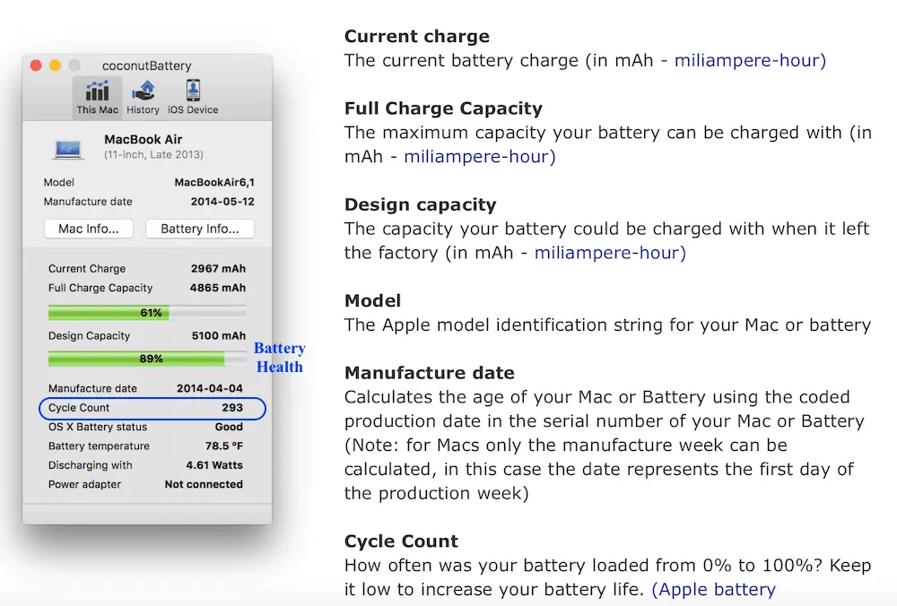

Hi Sam.. - welcome to the forum! :) The iPad Air was released in the fall of 2013, so the first models are pushing 4 years of age (not sure if your device @ the 2 years mentioned above means that you bought a 'used' device); but, if so the battery may be the issue - in addition to the comments already suggested, 'Reset' the iPad & charge fully to see if there is a difference (the maneuver is done by holding down both the ON-OFF & HOME buttons until the Apple logo appears which may take 10 secs or so - then release and allow the iPad to reboot).
If of no help, download Coconut Battery if you own a Mac computer - the app will determine your 'battery health' and 'cycle count' (see pic below) - if your cycle count is 500 or so, then your battery health should be 80+% - if your battery health is a lot lower, then that may be the issue. Dave
