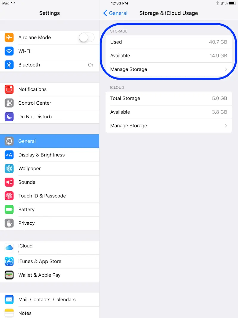

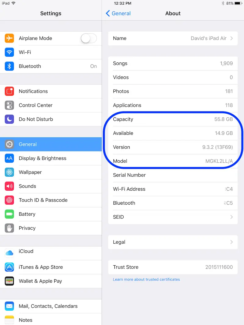

First, go into Settings -> General -> About; look at the right-column and my first image below; please provide us w/ what I have circled in blue, i.e. capacity, available, version, & model - then we will know which iPad you own and the iOS installed, and also the original storage and what is left.

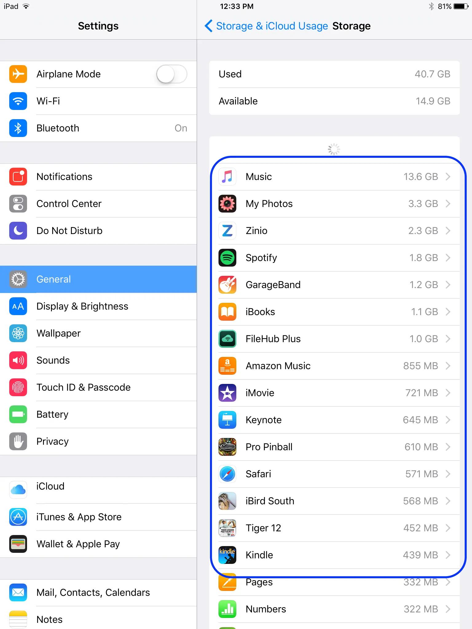

Second, from Settings -> General -> Storage & iCloud Usage, go into 'Manage Storage' (see the second image and the blue circled items again) - click the latter which should bring up the third image below - tell us the top items taking up your storage - you will need to concentrate on the 'storage hogs' and either eliminate apps and/or their data (e.g. pics, mags, books, etc.) - please post back. Dave :)

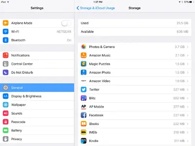

see attached for data hoggers.

Hi again - thanks for the information - you have an iPad Mini 2 w/ 32 GB storage - also, you have virtually no available storage left, which is likely your main problem, so that needs to be remedied. I looked at your 'storage usage' and the top items shown add up to about 10 GB only (the remaining 'not shown' MB items are unlikely to explain 'where' your other 'used' 15 GB may be?).

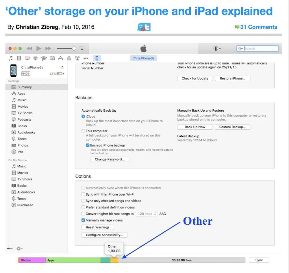

A common problem in iOS storage is a category called 'Other' - check Link 1 and Link 2 for an explanation - I suspect that this may be a possible issue. If you backup your iPad to a computer, i.e. iTunes - I would suggest that you cable the device, open iTunes, and click on the iPad icon (left upper corner on a Mac computer - assume similar on a PC but don't know).
At the bottom in the iPad panel, a storage bar graph should be shown w/ colored categories (see image below from Link 1) - the 'yellow' bar is the nefarious 'Other' category which for whatever reason may use a LOT of storage - if you can tell us (or upload an image of that same view), then other suggestions can be offered; both links explain this storage item and offer ways to reduce this category - sometimes an iPad needs to be 'restored' from a backup - but let me stop there to allow you to respond. Dave :)
