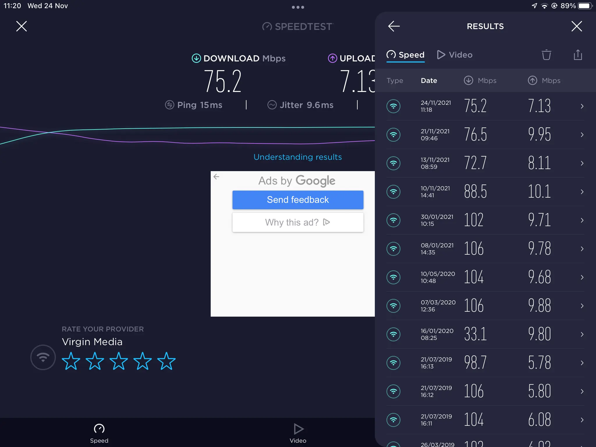

I get about 30 Mbps down and 4 Mbps up. However, my internet often goes out in the evening. No idea what causes that. I also have my wireless plan through Verizon which is a bit slower, but much more reliable. Since most of my devices are on the plan, I have it as a fallback.
I phoned Virgin about this once they said it’s because there are way more people on the net in the evening.
