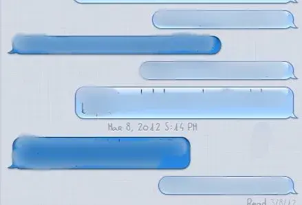

yeep aware that imessage and sms are in different color .. but what is happening on my imessage is that all boxes (the send and the in coming) both are in blue color .. while the send box in the usual light blue and now the in coming box have a darker blue (usually grey ..) ..

.. well, i guess there is nothing can be done with this occurance ..? .. fatboy or anyone with any thought .. ??..
my imessage still function properly although a bit hard to read the in coming message wit the blue color ..

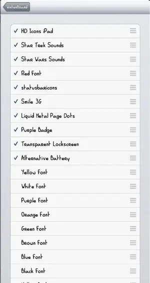

@marilyn ... i do not have any blue theme installed at all .. all i have on my winterboard is what is shown on the imsge below .l. nothing else . i have tried uninstalled everything once, but yet the dark blue on the bubble still showed up with the in coming chat ..

Checked the /var/stash/themes ...
Upon checking all my installed themes on winterboard, there are only 2 themes that have the .. theme/bundles/com.applechatkit, which are :
- Blaze ipad theme : has exactly the same png files as "point 1" above on its bundles/com.applechatkit/
The other theme :
- Blueipad V2 themes IOS 5 add on : has only Balloon_2.png. &. Ballloon_Blue.png. ..
- Blueipad V2 by JMG : interestingly has "fond wall blue.png" on its folder, but do not have com.applechatkit on its bundles
(note that those themes are on the winterboard, but currently not "checked" as installed .. they just sit on the winterboard ..)
As for my other "themes", none of them has com.applechatkit on their bundles .. Some have only "com.applespringboard" inside its bundles folder ..
