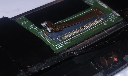

See the below image. If I'm careful I can hold everything 'in place' and the screen turns on and
displays correctly.
It looks like just the two solders at the end (which appear to be for grounding but also perhaps to hold
the connector in place) are loose.
I have a soldering iron and have done PCB soldering before - but on a larger size board... Could I attempt to solder this
top piece back down??

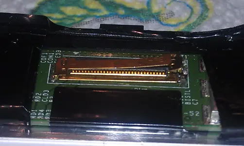

This is from the other side:
I have a few more but I'd have to resize them (1M limit here it seems...)

I don't see that you have a lot to lose by trying. You can't really leave it that way and expect to have a usable iPad.
The main think is that you'll want to keep the heat to the minimum. This is how I would do it, based on my limited experience with heat sensitive components.
Use something to weigh the piece down into place. Using a fairly small solder diameter, place the solder on the joint, then place the soldering iron on top of the solder. Lift it as soon as the solder flows together top and bottom. Let it cool down before doing the other joint.
The main thing is to avoid an accumulation of heat. I don't know if this component is heat sensitive, but no need to take chances.
At least you found a visible problem. So often it's difficult or impossible to see what's wrong.
Good luck, again.

Using flux is critical if you wish to solder that down without burning things up.
