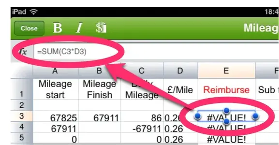

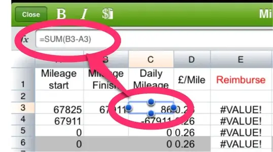

Here is the problem, in the first image I am calculating a total of one cell minus another cell, this works fine. In the second image I m trying to calculate the previous answer multiplied by another cell......but it isn't working and despite all my efforts I can't get it to work.......your help would be most welcome.

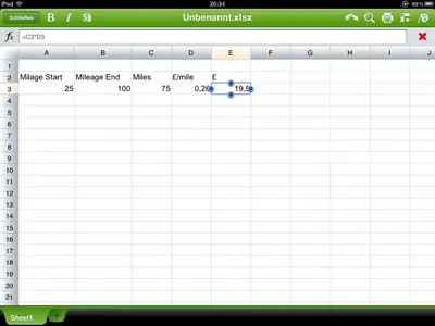

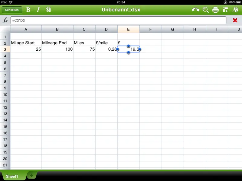

Nothing wrong with your formulas, it's all about the format!
See below, I used your formulas and there is no problem - just in the £/miles you put a "." as the decimal separator, I put the "," - do NOT ask me why this is not depending on the country settings in Quickoffice (or it might well be) - I am using the German setting on my iPad.....
I just recreated your sums in my quick office pro.
Try removing sum and brackets..... So. You have. =b3-a3. And. =c3*d3
Give that a go.....worked on mine. :)

Thanks guys, I really appreciate the help. psy's solution worked so I am a happy bunny again and can keep my mileage updated!

A probably unnecessary explanation.
The SUM function adds up all the cells in a range. You don't put an arithmetic formula inside it; just the first and last cell in a range that you want to be added up. Say you wanted to add up cells A1, A2, and A3. You'd enter SUM(A1,A3) and you'd get the sum of all three cells. {Cell separators may differ from app to app, it might be SUM(A1:A3), I don't remember what Excel's separator was.}
You just wanted the difference and multiplication of two cells. The only functions you needed were the math operations inbetween, the (-) minus and (*) multiply operations.
