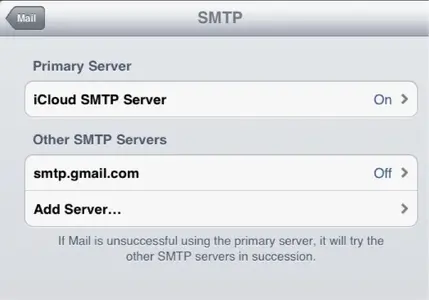

Try going into the Advanced settings of your default account. When you tap on the smtp server it should show you the primary server , and some others (from your other email accounts). Make sure the primary is correct, then try turning off any secondaries ( or on if they were off).
