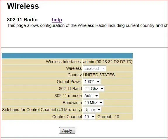

I've got the following Wireless settings in the Router (which I can change). See attached screen capture.
I've seen some internet posts that suggest the problems lie in the above settings. I've moved the bandwidth to the 20Mhz band, the sideband to lower, and the control channels have been tried on a few different ones. I know the 5.0GHZ shouldn't work. Still, even with those changes, the speed readings do not change much is any.

The iPad doesn't have a true .11n antenna, as a result, the highest speed you will ever get in real life is around 20 Mb/s. Essentially the .11n is only slightly faster than the .11g network. The highest theoretical throughput of the iPad's antenna is 65Mb/s, even when it is on a .11n wifi network, which can support 300Mb/s.
The reason being that the way the wifi antenna was built, it doesn't support the features which make .11n faster than the the .11g wifi.

That sounds about right. 22Mb/s is the max mine ever got with speediest.net and that was using a fiber-optics inet connection.
The wifi protocol is fairly inefficient, so you will rarely ever reach a throughput of 50% of the theoretical throughput. So your iPad is performing normal, it's just the design of the wifi antenna which prevents faster transfer speed.
