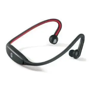

My iPad goes on forever searching for a Bluetooth connection, won't pair with my S9 Motorola headphones. S9 works great with my Touch. Help appreciated - IM

Make sure that the headset isn't already paired with another device like your phone. I've had this problem before. Good luck

Thank y'all for your help and zingervid for the solution. Unpaired from my Touch and the S9 paired with the iPad - IM

I had a great deal of difficulty getting my ipad to pair with S9 as well. Finally got it to work by shutting off bluetooth on my laptop and on my iphone. I also told my iphone to "forget" the S9. When all of this was done, I restarted the ipad and S9 headset and then my ipad saw them and paired successfully.

An update to all the bluetooth chatter. I own an iPad2 with the latest OS. Just purchased the Motorola S10-HD stereo headphones (bluetooth). At first the iPad wouldn't recognize them, however, I reset the headpones to factory condition removing previous profiles. Viola! they connected. I hope this helps other folks, as I was about to box up the headphones and return them to WalMart. Also, the instructions included with the headphones say that you will need the bluetooth D670 adaptor for ipod...this may hold true for the actual ipod, but you DO NOT NEED to buy the adapter for an iPad2. I can forward through my music, pause, stop, play...fully functional!

mapgirl1974 - Cool, and my problem was that I had my iPod Touch on, competing with the iPad. Enjoy your iPad 2. I'm still happy with the original, but sooner or later :) - Best, IM
