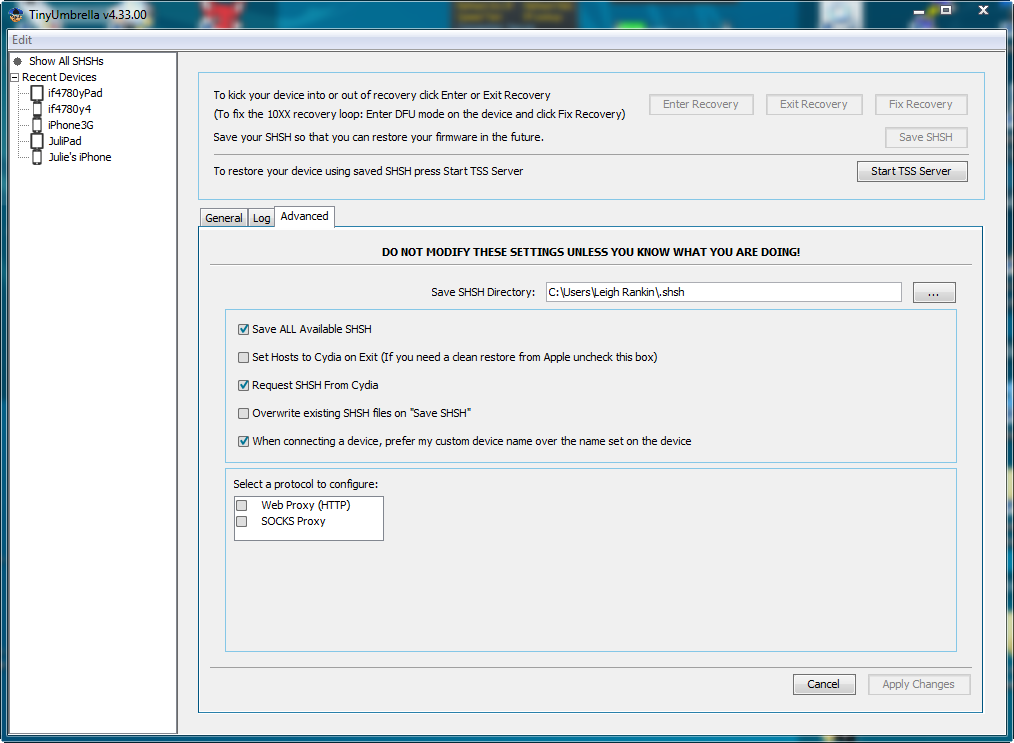

By default, TU will set your hosts file to point to Cydia when it exits. You can tell it to point you back to Apple servers easily. If you don't already have TU, you can download it from - The Firmware Umbrella - TinyUmbrella
Start TinyUmbrella, switch to the "Advanced" tab, and UNTICK the option which says "Set hosts to Cydia on exit".
You can see the option, which is the second check box in the list, in the following screenshot:
Once you have unticked the option you are done. Just exit TU and your hosts file will be back to normal and pointing towards Apple. This is the best way to leave it. If you need to restore using TU in the future, just press it's "Start TSS Server" button. You never need to change the hosts option again. Just leave it switched off and TU does the rest.
