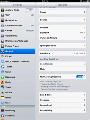

a picture of my general settings tab which does not have "restrictions" or a lock pass code option, or even a reset settings option, very very odd
image.webpclick to view larger

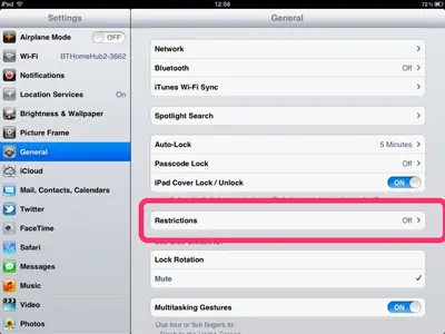

Check out this image (tap on Restrictions to open up the options)......
That is definitely not right. Saying that - no clue on what's going on or how to fix it.
