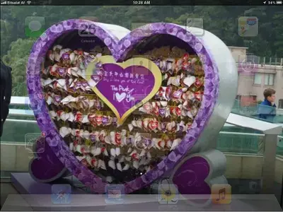

Hi,
I have trouble seeing my app icons clearly after doing some Cydia updates which Cydia asked for that!
I attached here a screen shot, and hope anyone can help me with a solution!!!?

I suggest you open Cydia and remove anything which allows you to adjust the transparency of icons or the springboard. Alternatively open Settings and check the transparency settings for apps or tweaks in a similar way. Candidates may be Alphacon, Sprintomize, etc.
And you should always CHECK what is being updated. Cydia does not force you. It tells you there are updates and allows you to choose to install them or not. Blindly accepting updates is a sure fire way to get yourself into trouble since you have no idea which app or tweak was updated! ;)

I removed few programs but doesn't help. But after removing a program called WinterBoard and rebooting my device, the problem solved
Thanks guys for your help ;-)

You had therefore activated the "Dim Icons" theme in Winterboard, which makes sense... You choose which themes to apply in Winterboard by ticking the relevant theme names. If you reload it, make sure "Dim Icons" is NOT ticked and your problems will be solved.
