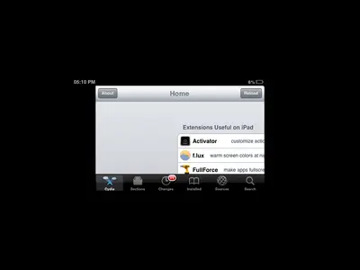

my ipad 2 is jailbreaked ios6.1. everything was running smoothly still is untill i went onto a piracy site and downloaded some apps. i synced them on my ipad, all went smooth apps work perfectly but now cydia and appstore isnt opening properly. ive taken screenshots, they open but the screen is so small and i cant press anything.. please help. is there a way of fixing the problem without having to start again? photo.PNG please reply asap..

ronnie1234 said:
my ipad 2 is jailbreaked ios6.1. everything was running smoothly still is untill i went onto a piracy site and downloaded some apps. i synced them on my ipad, all went smooth apps work perfectly but now cydia and appstore isnt opening properly. ive taken screenshots, they open but the screen is so small and i cant press anything.. please help. is there a way of fixing the problem without having to start again? <img src="http://www.ipadforums.net/attachment.php?attachmentid=35581"/> please reply asap..
You are a thief and a pirate;
Here's all the advice you will receive. Remove the apps you downloaded from that piracy site and your iPad should start working properly.
Stay legal, pay for your apps.
