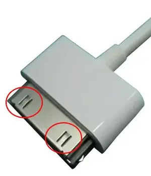

But story first. I living in Ukraine and there is no official AppStore, so I had purchased my first ipad (1st gen) in US two years ago. I had enjoyed it for three days and then I got exactly the same problem as your, no charge icon, not recognized by mac, PC, itunes...
So I went to AppStore and they replaced ipad with new device. I had used it for about a year and then... the same problem. I was very angry and disappointed. I have tried all possible solutions: different cables (I also have iphone, and iphone 4), DFU mode, different computers (PC and Mac), etc.
As I mentioned above there is no AppStore in Ukraine so have paid 200$ for replacement "Charger Flat Cable". It fixed the problem for some time. But 6 months later the same issue has appeared again.
I decided to leave ipad, I didn't want to spent money again. My wife used ipad for web. But some months later I was very wondered because I noticed that ipad displayed charging icon when connected to wall charger. I have connected it to my mac and it was ok, itunes has recognized it. I was impressed. Next day ipad was not recognized by itunes. I thought what the...?
I have started to swith on/off ipad to cable many times and I have discovered that if push 30 pin connector with some angle then ipad has been connected, also if switch on cable, put ipad on the table (face up) and pick up ipad through the cable (by holding cable only) then charging icon appears for a moment. So cause of this problem is bad connection.
Solution:
I did next thing: arched up 4 connectors (marked with red on picture) 2 on the top side and 2 on the bottom side. You should arch it up on 1mm, no more. That helped me.
If somebody will try this method, then please reply in this thread. Good luck ;)
