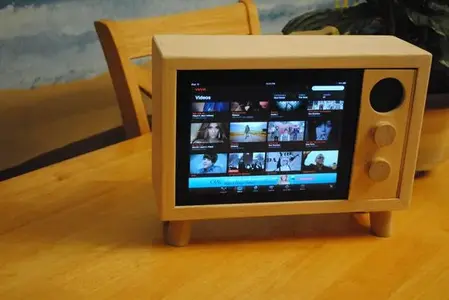

I just started an Etsy Shop where I'm building and selling my wooden iPad, iPhone stands and other accessories. I'm probably about 2 or 3 months into it and though I'm getting a lot of "Likes", I'm not really getting any verbal feedback. I'm just hoping to get some ideas/ suggestions from people who have probably already seen alot of similar stuff. I'm not trying to become the next "Otterbox" or anything but I'd like to make a decent living eventually as it's fun and satisfying to do. Please check out the link in my signature and tell me what you think.

The other item I looked at were your "TV boxes". To be honest with you, I see those as a novelty only and at the price you have I would have a hard time justifying buying one. I don't think it's something I'd leave my ipad in all the time and not something I'd carry from room to room. As with the other stand, people my not be willing to remove their cases so you'd want to try and figure out a way to make the space inside adjustable to fit the ipad with or without a case.
