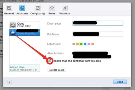

Go to icloud.com on your computer, open the Mail app, and then Preferences under the gear icon at the top right. You should see something like the attachment below under the accounts tab. Select each alias and make sure the send/receive mail as alias is checked.

Thank you so much for your reply--but I did check, and my alias was already checked on my computer as you had suggested.

You can also try it from the other end. Uncheck the alias box(s) and exit the preferences (to force a save), then go back in and re-check the box. This is simpler, so you might want to try it first. {I always seem to think of the easy stuff last, hmmm}

Thank you so much---I tried the two last things you suggested, which did not work at first, but after restarting the iPad, they did work! Now I can again send from my alias!
